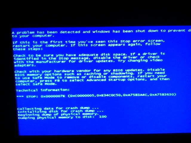

I took a picture of the BSOD, in case that can help in anyway. Hopefully the link works.

Well, the crash is occuring because a System Thread is crashing, due to a memory access violation. Could be due to said virus, but the fact the system is comming up clean...

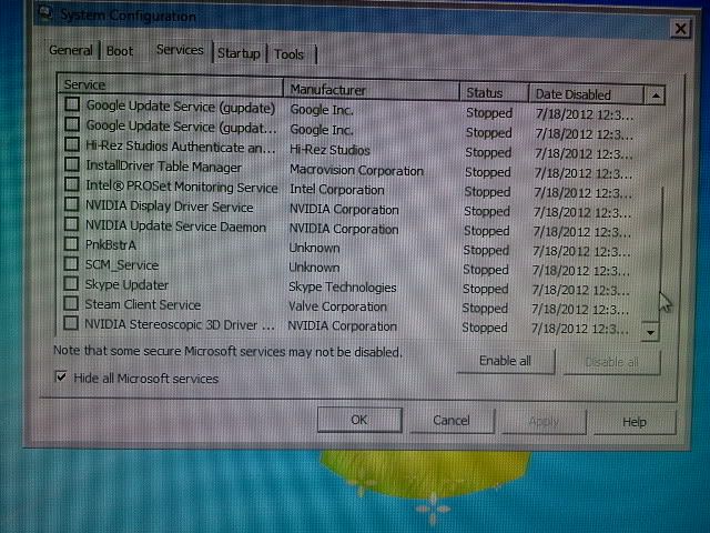

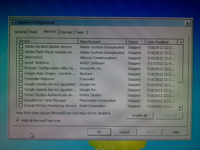

To make it easier, I will provide pics of the things you listed. They will be up shortly.

Services Tab Under Msconfig
OK back to msconfig. and select Selective start up. You will have 2 check boxes corresponding to the startup and services tabs. Go into each tab and uncheck every box (keep hide ms services checked). Now start one at a time checking the boxes and restarting the system (hit apply when you check a box). I would start in the startup tab first. At some point expect the system to BSOD and you will have to go into Safe mode to get in. You will then make note of what you checked that crashed the system, uncheck it and continue with each item in both tabs until done. We are trying to find what start up item(s) or service(s) that are causing the crash. GLHF
Don't worry about the device manager stuff the exceptions are probably cause by not having an item in start up or services running.
