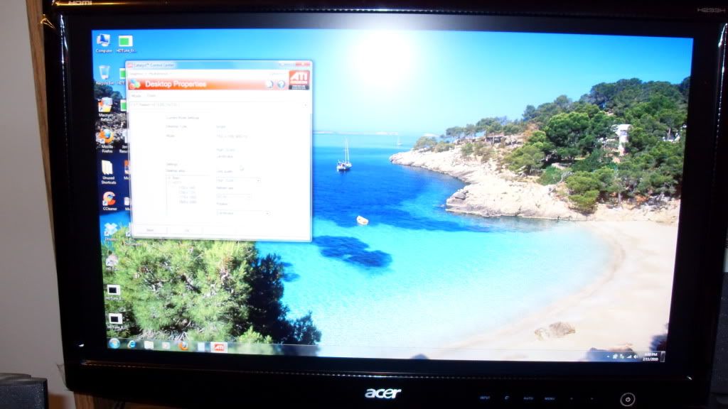

Hi everyone,
So, I just purchased the Acer H233Hbmid Black 23" 5ms HDMI Full HD 1080P Widescreen LCD Monitor 300 cd/m2 40000:1.
I wanted to set the resolution to 1920 x 1080, but for some odd reason, it doesn't fill the entire screen (see below image, it's the best I could get with my camera) - it's like there's a 1 inch boarder around it or so (and there's no option I can find to "stretch" it horizontally & vertically. Oddly enough, if I go down to 1690 x 1050, then it fills the entire screen. Below is an image of my available options with my ATI 4350. 1920 x 1080 is listed under "HDTV" where as the 1690 x 1050 is listed under the "PC" section.
Any ideas on how I could use 1920 x 1080 and fill the entire screen? I'm using an HDMI cable for hook-up. Is this monitor defective or is this just how it is?
(I'm new to the widescreen monitor world ;))
Thanks,
Steve

  6. I have the H24H
    Also ran into this problem with hdmi. Go to ATI catalyst control and then select the "desktop and displays tab" then at the bottom
    where you see the icon of the display right click and choose "configure" you will then see some extra options to adjust the resizing and overscan I think its called set it to 0.

  8. RoyJonesJr said:
    I have the H24H
    Thanks!!!!! I messed with this forever, as a detail, right click on the screen on the bottom, not the identified one inf the middle of the screen, that fixed everything.

  12. RoyJonesJr said:
    I have the H24H
    Thank You. Set Scaling Options to 0% and the problem is Solved!
