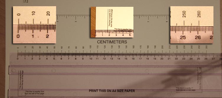

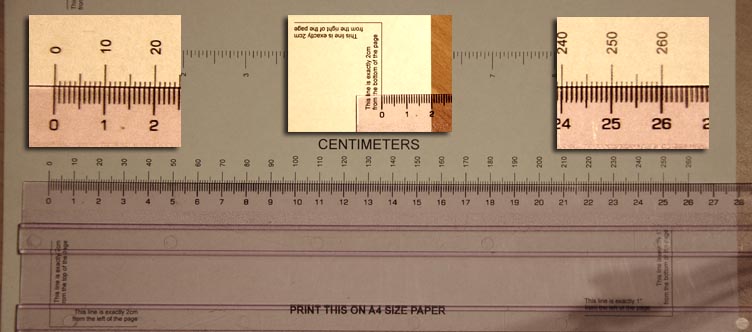

    to illustrate the problem, here are two (very bad but they get the point across) images:
    Here is a ruler I printed on card stock on my CM2320nfi. The printed size is spot on:
    And here is the same printed on the same medium on the CP4025. Notice the difference.
    If you want to print out these rulers yourself, check further down.
