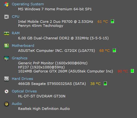

There shouldn't be. I recommend installing GPU-Z and monitor your temperatures and fan speed while playing a game. If you can report back some numbers, we can dig a little further. If it's staying under 85 degrees C, there should be no worries.
How do I figure out my temperatures?

So, is it my Graphics card that is overheating? Or what.
thereconcheck said:
....So, is it my Graphics card that is overheating? Or what.
Yes, you can see from the screen grab you posted under the Graphics section - your video card is at 90Celcius, which is Very High
