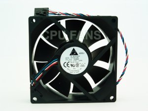

    5. This is original 5 pin/4 wire fan for 4700 http://cpufans.ecrater.com/p/5156787/dell-fan-dimension-4700-g5883-n4399?keywords=G5883#
    6. So, some information about CPU intake fan, please correct me if I am wrong
    Quote:
    The fan is not a standard 92mm x 25mm fan. It will either be 92mm x 32mm or 92mm x 38mm and should have a special 5 pin connector that connects to the motherboard fan header. It will be mounted with rubber shock mounts (unless the original configuration has been changed). If the fan is changed the rubber shock mounts (called rubber screws) should also be changed.
    I really hate proprietary Dell connectors...
    7. So basically you need this part, I hope I am right (in terms of part number) http://www.centrix-intl.com/details.asp?productid=1076 link provided for information only, have no idea where it is located.
    And fan should blow inside.

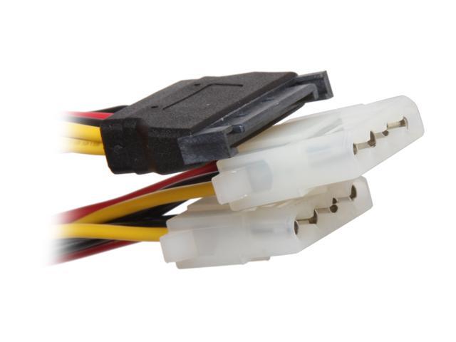

  33. if you have at least one SATA power connection to spare you will need this part, you need SATA male to Molex 4 pin, because power supply provides SATA female connectors
    http://www.cyberguys.com/product-details/?productid=48800
    Or this from newegg
    http://www.newegg.com/Product/Product.aspx?Item=N82E16812226018
    I hope fan uses less power than SATA HDD.

    In order to place a fan on CPU cooler you need one fan, about $7-10, one connector about $4, zip ties $2 or so, plus all those items will require for you to pay shipping, so on minimum you are looking into at least $13 plus unknown shipping costs, so you would easily go over $20 USD, and there would be huge headache to put things together.

    Kisianik posted this link http://www.centrix-intl.com/details.asp?productid=1076 where you can get the brand new OEM parts (#N4399 which is for both the OEM Fan and Shroud) at a very reasonable price. This should solve all your issues here.
  46. I applaud you, Idonno, with your Dell's quote, where you get it from, link please - I have myself similar setup with XPS GEN3 on which I am typing now, and sometime ago I was thinking about reversing my fan as well, it took me long time to come up with the same conclusion, I wish someone helped me with that quote about 3-4 years ago.
    So this is my SUPER cooling setup, LOL well it is working and not so noisy
  47. what processor are you using with your XPS Gen3
    Here you go: http://en.community.dell.com/support-forums/desktop/f/3514/p/17976554/18099540.aspx#18099540
    I've also added fans to my 4700 one on the hard drive cage (closest to the center of the case) blowing on the drive, One on the side panel blowing on the video card and one under the front bezel to blow air out.
    Pentium 4 3.4GHz HT or full name Intel Pentium 4 550 Prescott, XP Home 32 bit 4GB RAM (2x2GB) actual RAM in use only 3GB, 3 SATA I HDDs, 2 of them have coolers and there is small fan as you can see mounted outside and it works for the third one without cooler, and it also adds air to GPU, which is 8800GT Dual, the rest is standard more or less.
