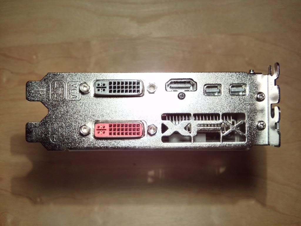

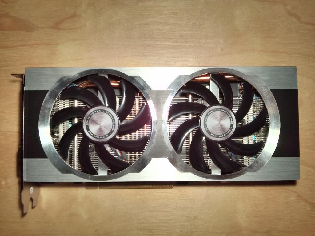

So...I recently bought an XFX HD R7870 Double Dissipation
...and since there it wasn't any here in greece, the shop I bought it from had to order it from somewhere else...now, I don't know from where it had ordered it but that is not the point.
When it came, the box and everything was exactly how I was expecting it to be ( I've seen unboxings ) but the card was different.
1) First of all, the fans seem slightly bigger and there is no XFX sign between them...
2) The card is "open" at the front and not aerodynamically closed ( sort of ) like the others I've seen...
3) On the Red bar it says: "XFX R7800 SERIES" instead of "XFX R7870"
4) But the BIG difference is that instead of two 6-pins inputs, this one has one 6-pin and one 8-pin!!
And not only I can't find anyone online with this card with one 6-pin and one 8-pin but EVEN THE BOX SAYS TWO 6-PINS!!!!!!!!!!!
However, I plugged in the gpu, and it seems to be working as it should...it reaches quite easily 100 C
( with gpu rendering benchmarks )...but my question is...which version of the card is this???? ( it says V4.0 on it )
I mean, If it is a newer version, then it's ok, but If it something like a BETA or a faulty version I would like to know it because I am going to exchange it then with the other version...
Thank you in advance!

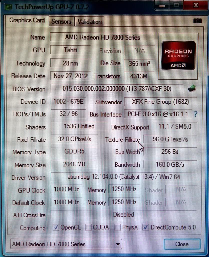

I am not sure what version of the card you have. I am pretty sure it is not a new version, as new versions tend to be better. If the card hits 100C with that cooler, it certainly is worse. I would suggest using the tool GPU-Z to check and make sure it is even a 7870.
If it is a 7870, then it sounds like someone for some reason took a XFX 7870 and removed the original cooler, replacing it with the worse ones you currently have. They may have done this hoping they could make some extra money selling the coolers to someone else, since they will work on other cards.
A picture of the card itself, and the GPUZ would be helpful to figure it out. Like you said earlier though, returning it is still the best option. Unless they gave you a bigger card like a 7950 or something, which unless I am mistaken uses an 8-pin and a 6-pin power connector. Though, that wouldn't explain the bar that says "XFX R7800 SERIES"

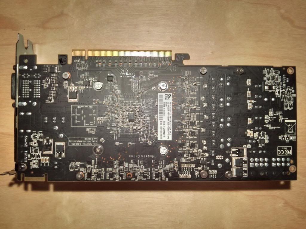

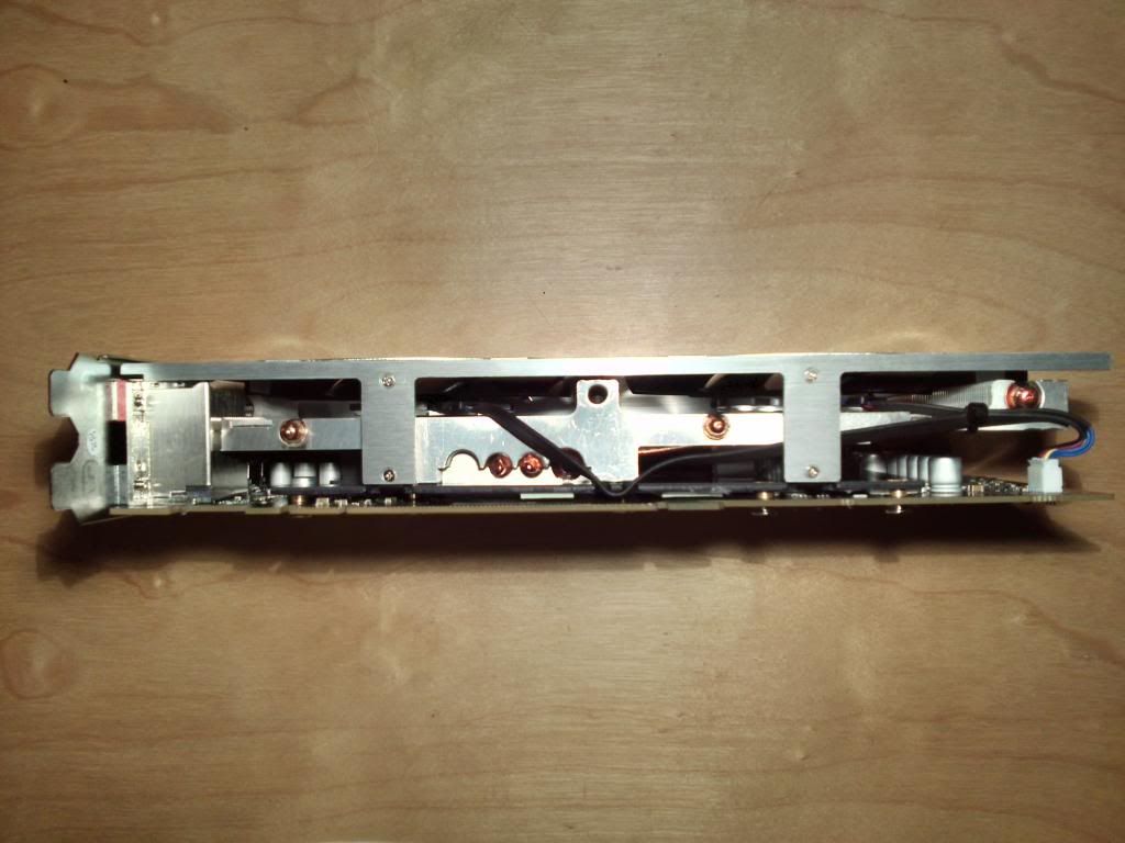

Thanks for replying!
Here there is a picture of the GPU-Z and some photos of the gpu: ![]()
I'm I the only one on the planet with this one?
On idle, the temps are around 47 C ... when it reached 100 C it was because I was doing some gpu benchmarks and it was working at 100% ... it was still really quiet though. Also my case has not a really good airflow.
Anyway, maybe it's even better than the normal double dissipation version because:
1) seems like it has bigger fans and it is open at the front ( that means better cooling )
2) it takes an 8-pin which usually bigger gpu's take...( 7950 )

Like the guy above was saying its a 7870 using Tahiti chip instead of the regular one. There is quite a difference, the 7870 has a few hundred less cores, and the default clock is usually different. Here is a review of a similar card from another manufacturer.
http://www.tomshardware.co.uk/tahiti-le-7870-7930-bench...
The reason for the differences you pointed out is because Tahiti is the core type used in the 7950, but its cut down a little. It still pulls more power though, and thats why it has an 8-plug pin. It has a good bit more power than the regular 7870 though.
As for your heat problem, I would think maybe the thermal paste on it has gone bad or something? The card should run hot but not that hot. I would try putting some really good thermal paste on it then trying it, and if needed turn up the fan speed in AMD overdrive.

I was expecting something like that...on the AMD Website it says that the HD 7870 only has 1280 stream processors...now this one, according to GPU-Z, has 1536...! Also the memory speed is 1250 Mh/z instead of 1200... and it has a slightly higher bandwidth...
So...I guess I won't return it and I am going to consider myself lucky...'cause even the box didn't "knew" what there it was inside
Also, I don't think I really have any heat problem now
...the temps are around 47 C on idle...when I push it, it reaches 80-90 C... it only reached 100C on benchmarks so I guess it is fine...my case airflow is not really good though...

Yes the difference with the stream processors is because the Tahiti core has some 2000 stream processors, and 25% of them are locked off. Most likely they have been laser cut. Your bandwidth is higher because the RAM frequency is up. Seems that XFX took care to give it a pretty good overclock before sending it to you. Just try to cool it down a little. Still an excellent card
