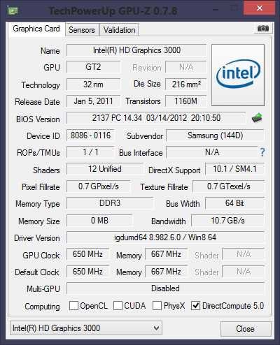

current gpu-z results:
http://gpuz.techpowerup.com/14/05/20/dv0.png
http://gpuz.techpowerup.com/14/05/20/20c.png
Results of gpu-z should be like that:
http://www.techpowerup.com/gpudb/380/radeon-hd-7670m.ht...
I didn't understand why bus width shows as 32bit while it must be 128bit. And i used worse system like c2d 1.8 cpu, 2gb ram and 512mb@256bit gc and had zero problem with same programs, games.

Your graphics card is meant to have a bandwidth of 28.8GB/s not 7.6GB/s as listed!
Have you check information in BIOS?
May 20, 2014 4:23:45 AM
Additional: I checked the bios. It seems samsung don't give many options to users. Only option about performance was energy saving mode. I choosed as disabled. After that, performance raised like at first benchmark fps rate was around 17 now, it's 29. Still not good as expected but better. However, bandwith lowered to 4.8 gb/s while bus width raised up to 128bit as expected. I am really confused.
My guess is samsung lowers computer's performance to have stability and less consumption. However, i couldn't find a way to reach additional options about that.

now that the bus is correct, what is the core clock, clocked at?
May 20, 2014 5:18:55 AM
It's 899. Tryed some games and high size photoshop files, i can say that performance doubled already.
