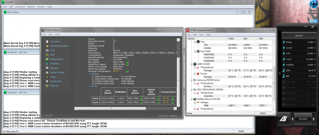

I don't believe it either but I can run Prime95 for a more than a few hours and verify temps with 3 different programs and it never appears to go over 35-40C.

I do use HWmonitor to monitor both temps as well as other apps to verify - see image in above post. I am not worried about my FX-8320 I am worried about my A8 6600k. The FX runs very cool - temp reading broken or not. They both have HyperCooler 212 Evo's cooling them. The FX-8320 runs "cool" the A8 6600k runs very hot when taking on the smallest of loads and rather warm while idling.
