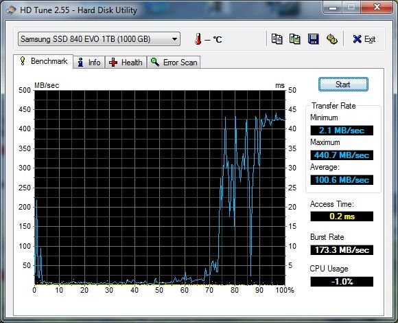

I guess I was not holding it wrong! *&@&%!!!! I had this issue from day one.
I'll have to try it out as for me it slows down the moment you write data to the drive not after 30 days.
http://www.kitguru.net/components/ssd-drives/matthew-wi...
