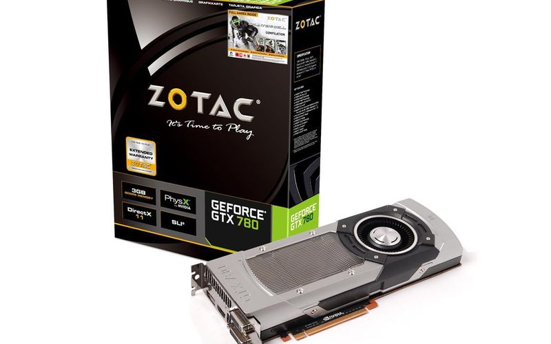

I don't think airflow is a problem, I have plenty of fans pushing or pulling so that cold air enters the front and bottom and hot air exits in the back and on the top of the chassis.
The card is the type with one fan, like this:
Since its a zotac card I'm going to try the firestorm software.
