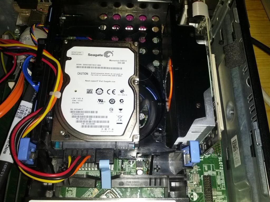

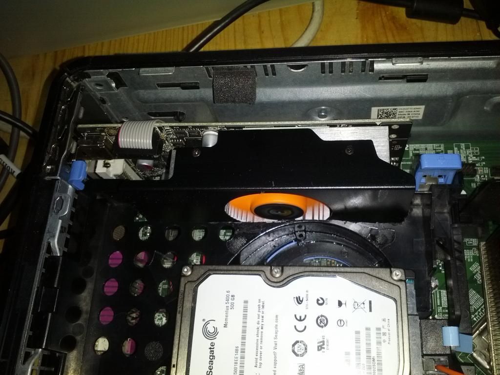

I currently have a ZOTAC GTX 650 in my Optiplex 760, with a 3.0Ghz core 2 duo. I would advise against this if you have the lower wattage PSU and a core 2 quad. I drilled 2 holes in the bottom of the hard drive tray allowing me to install a 2.5" drive, then cut away the side of the tray necessary to fit the card. Be very careful not to damage or trim too far into the fan housing or the clip that holds the tray in. Here is how it looks.
